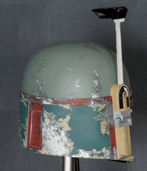

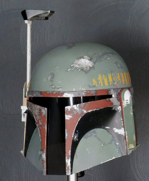

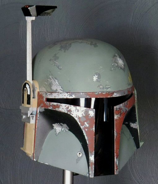

Finally, just to show how different things can look under various lighting conditions, here are a few more pics. The set I took
yesterday was under pretty dim indirect light through my windows. It was a stormy day yesterday. Today, the sun is shining
and I got some brighter light in my living room.

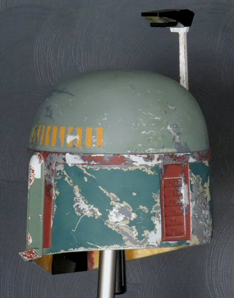

The back again:

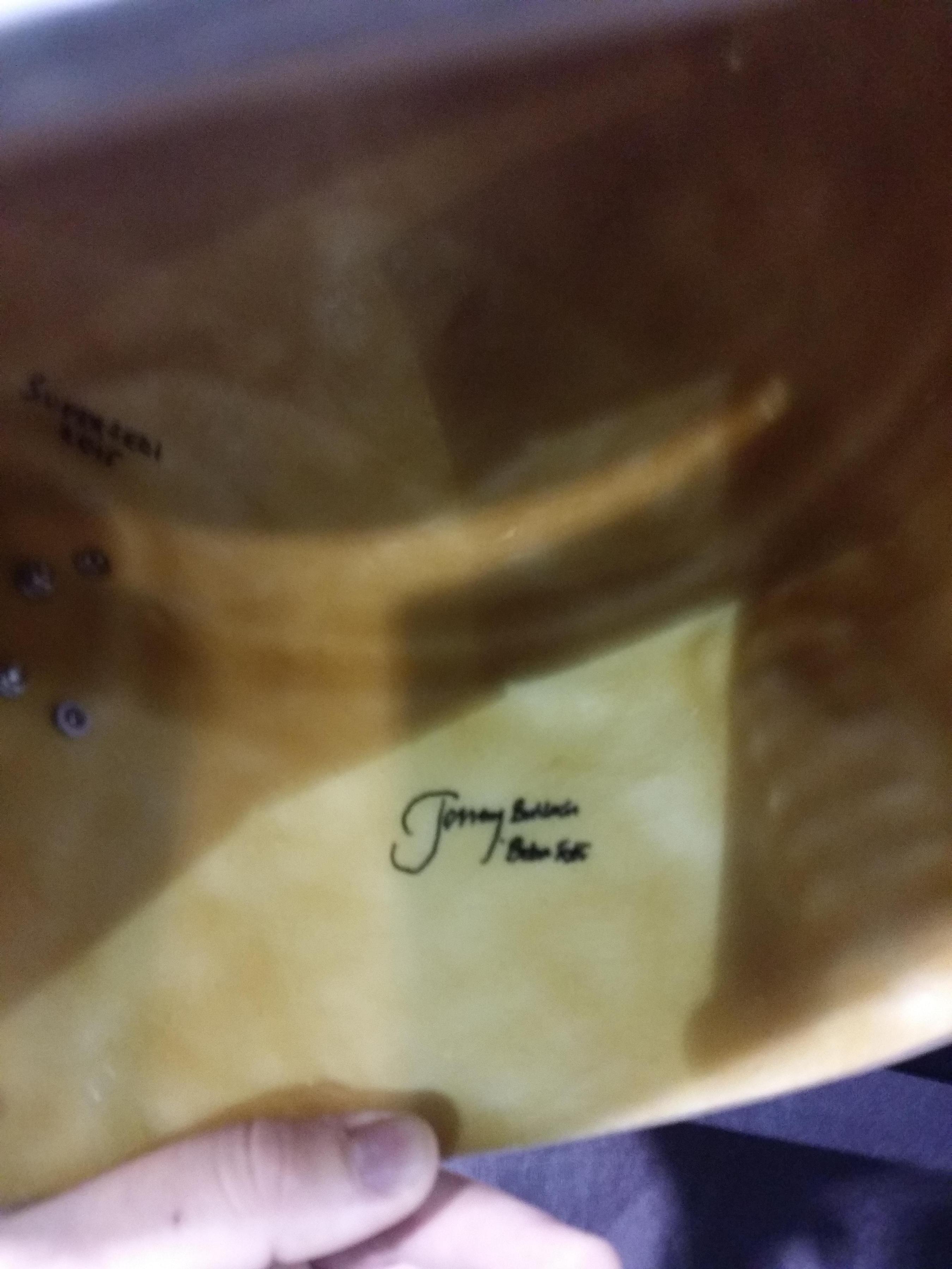

Well.. The helmet arrived safely and I can't express into words how happy I am with it. It's amazing! Thank you Eric. It arrived just in time to take with me to meet Jeremy. He is such cool guy! He thought the helmet looked so good, he signed it for nothing! He also thanked the TDH for everything.

Making good progress. :) Got the rear panels masked off and airbrushed the blue-green shade. As usual, I used my
Winsor & Newton masking fluid to block out the shapes. I finally had to buy a new bottle of W & N after about 5 years!
My original bottle just got too thick to be very usable.
After unmasking, I pulled up some reference pics and used a small detail brush to tweak the edges between the beige
and blue-green. I do this on all my paint ups. The masking fluid can be coaxed into some pretty intricate small shapes,
but I'm never quite 100% satisfied with all of the shapes. Here are a couple of pics.
On the left panel (above) there are some small details that I don't even bother masking off when I spray the blue-green.
I just do them topically afterwards during the tweaking stage. That's one advantage of painting in the "Layeropical" method. :)
On both the left and right panels, I go back with some of the blue-green mix and add some patches and shading using a small brush.
As I've mentioned previously, it's the same blue-green mix that I shoot through the airbrush, but when it's applied with a brush, it comes
out denser, and appears slightly darker.
This sets me up to begin doing the gray and silver detailing on the back panels, so that'll be coming up next!
