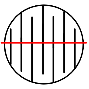

I have a small suggestion to make soldering the pads a bit easier - you won't have to be nearly as careful to avoid a short, and it won't make any functional difference to the unit.
The cheeseball diagram below pretty much shows it all. If you take a sharp X-acto or utility knife and carefully (CAREFULLY!) score the board where my red line is, you will effectively separate the pad in half. Don't cut too hard or deep; you should only have to make one or two fairly light passes to cut through the thin plating that comprises the pad.
From there, just solder your wires as usual. If your cut is correct, you can actually blob on as much solder as you want (not recommended, sloppy solder jobs make me angry LOL) as long as you don't bridge the cut you made.

Thanks for the great tip Rick! Maybe I can pick your brain one day regarding electronics and such! BTW, welcome to TDH!:)
