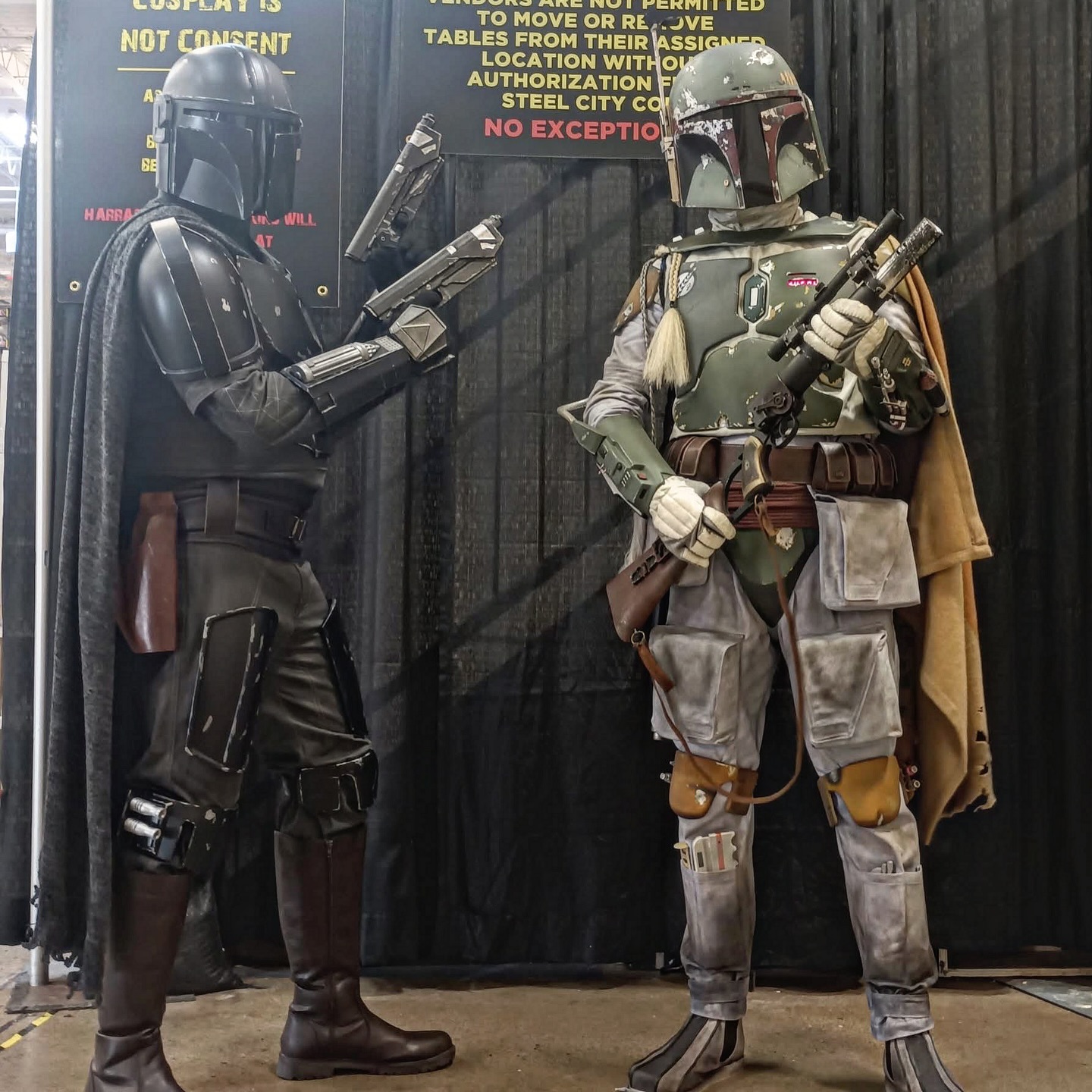

Another troop with Boba!
I made some adjustments before this troop - tightened up the spacing between the collar armor and chest armor. I also selectively boiled my thigh pouches to shrink them as they were still too large even with less foam in them. I think that the size is better now.
