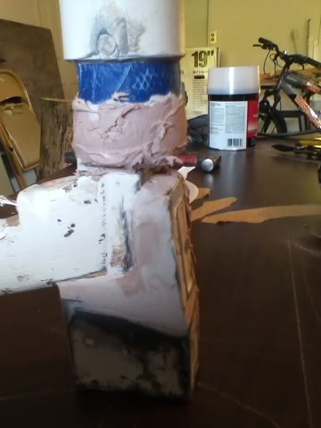

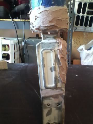

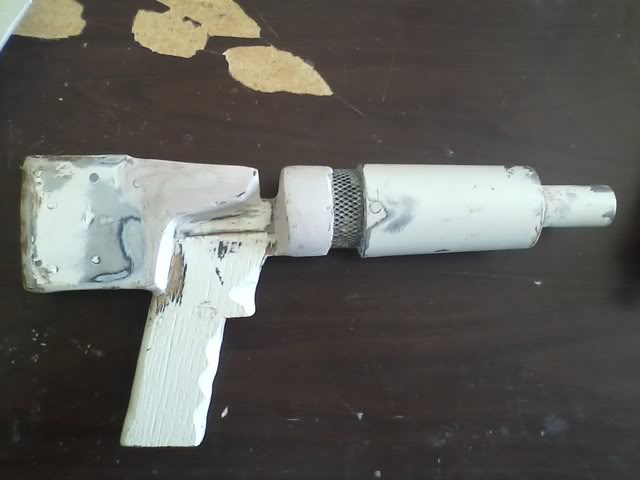

I've been modiying me gun to clean it up a bit, but the bondo gods must not be satisfied with my sacrifices because this last bondo application hasn't dried properly and it's been like a day. I think I'm going to have to scrape it off and try again. Pics prolly later today, maybe tomorrow!
I just have to say that your armor came out awesome. It has inspired me to start working on my own armor to go with my helmet.
eh be patient with the bondo... if necessary put more over it and sand, I wouldn't scrape it off quite yet.

The only thing I would note would be your gun, it looks a bit patched together and may need to look a little more solid, silver spray, toothpast and some cheap matt spray paint will also sort it.

Yup, the gun is totally patched together. I'm in the middle of fixing it up right now. I've slapped some bondo on it--making proper sacrifices to the bondo gods, of course ;) --and I have some pics of that...
I'm pretty close to all that being done and making a holster, then I'll move onto some better gaunts that aren't made out of cereal boxes. Between waiting for each bondo installment to dry, I played around with some supplies I had lying around.

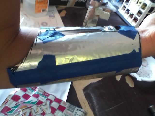

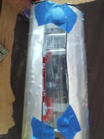

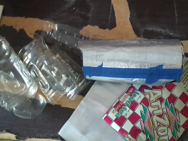

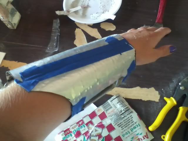

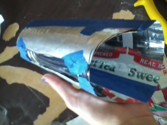

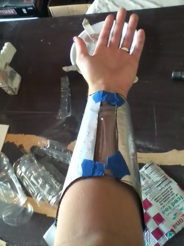

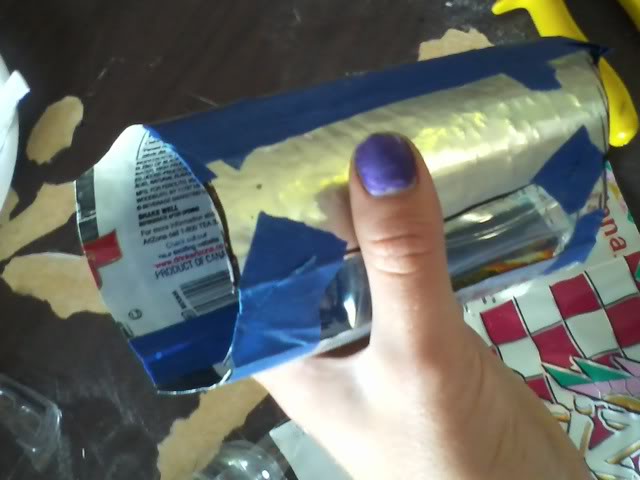

Mock up gaunts made from non other than Arizona Iced Tea cans! With a Gatorade bottle insert.

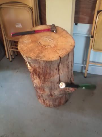

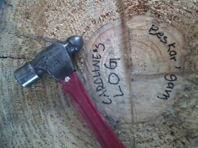

After my papa cut down a tree in the backyard I grabbed a giant log so maybe one day I can actually do my own metal work. I used that, a ball point hammer, and a baseball bat to shape the cans.
I'd say it was a successful day. :)

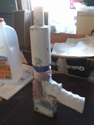

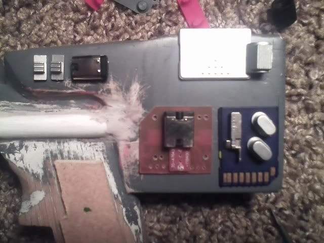

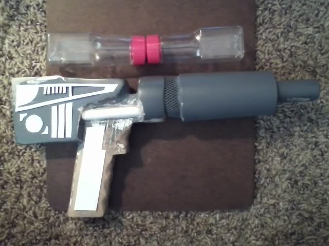

All right! I have been working even though I haven't been updating. First off, my gun is MUCH farther along -- nearly finished. I'll get to the details of that in a second. Secondly, I'm reworking my kit a little bit, sharpening it up, what not. I added some more velcro to a few front plates so they stay on better. I'm going to reshape my thighs and make new knees and shins. I am also working towards getting some heavy duty snaps so I can properly attach my lower armor and I have leather to use as straps. I'm also going to reshape my back plate to fit better. I think that's about it besides a few other odds and ends. I'm hoping to have my kit back together for the release of Episode I on February 10. Now! The pics...

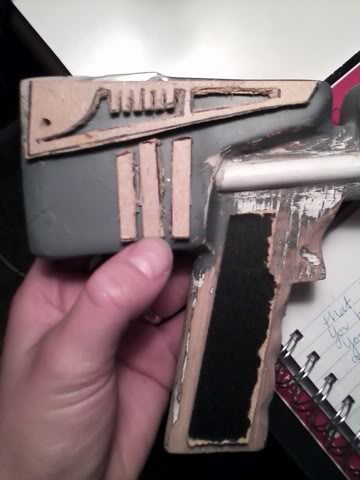

Got all the sanding done.
Primed it. I was having a lot of trouble figuring out what in the galaxies to do for greebs while it was unpainted. PRIME THINGS! It helps with "greebers block".

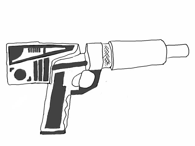

And this is my master plan for this side of the gun.

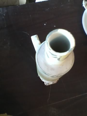

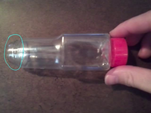

I had a brilliant scope idea from sprinkle bottles.
I cut off the threads and am going to put the cap on the end.

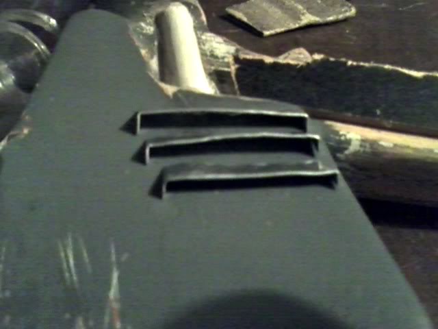

Updated design: turning those bars into fins...
...which I made from Arizona Iced Tea cans.
I cut out most of the pieces from a frame backing.

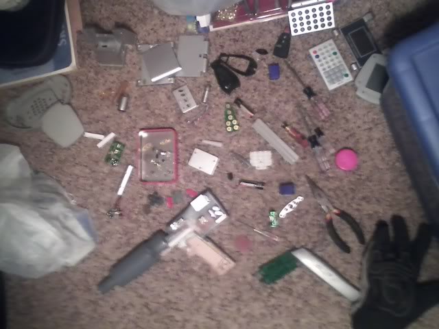

I took part in what I like to call "The Great Greeb Harvest".
Came up with this from all of that.

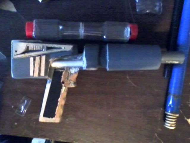

This is pretty much where I stand for now with the gun. I'm putting epoxy on those frame backing pieces atm and working on gluing the other greebs on.
Also picked up a pipe clip and bent it into shape to make a trigger guard (temp glued on with hot glue so I didn't have to hold it on for the pic).
So, it's a big post, sorry. Y'all needed an update. ;) When I get more work done on the actual armor I'll be back. Enjoy!

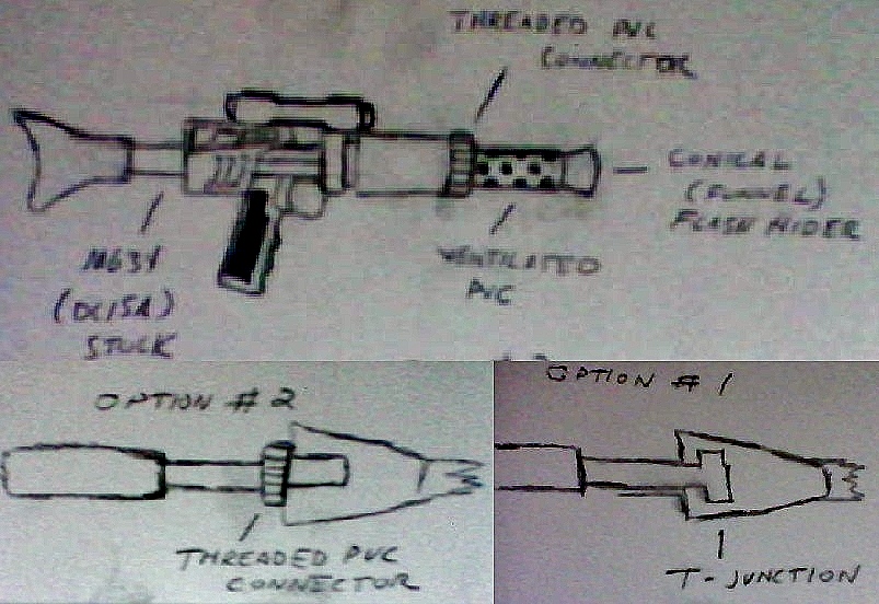

Ord'ika that blaster's looking better all the time. I have an idea for ya tho... just looking at it, I think it'd be awesome if you added a stock and extended the barrel a little bit, make it into a carbine. Take a look at the DC-15A buttstock (WWII MG34). I think with a little bit of shortening for your frame a stock like that with a slightly longer barrel would make that thing a beast.
I agree, that would be pretty beast. Do you think it's possible for me to build the stock and extended barrel like add-ons? I could carry the barrel and stock in a pack and pull 'em out when I really wanted to scare people. ;)

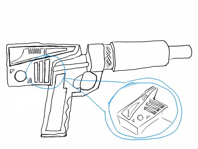

I threw together a quick sketch of what that might look like...

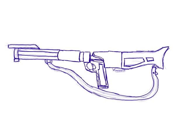

yeah it's certainly doable. Lowes sells threaded PVC connectors that can easily be used to make a barrel detachable. Might take a little more innovation with the stock but it's totally doable to make it detachable. How would you feel about modding the back of your blaster to fit a stock housing? I think I can come up with something pretty darn decent. I'm still working on my own blaster as well so... I'm kinda sharing some of my design process with you.
EDIT: So I came up with a sketch of what I was thinking of (sorry about the low picture quality my laptop has a bad webcam... no scanners at my deployed loc). Here's the 2 options I can think of right off the top of my head for attachment methods. The barrel would screw on using a threaded PVC connector (hence the removal of anything asymetrical). The stock can attach 1 of 2 ways.
Option #1 is the more aggressive approach. It requires cutting a T-shaped attachment point in the back of the blaster, and adding a matching adapter to the stock itself. Then use a metal/thick plastic plate screwed onto the top of the blaster to hold it in.
Option #2 is the more simplistic approach. Take another of the threaded connectors attach the "male" portion to the stock (using a dowel rod/pvc pipe for the stock tube) and the "female" threaded piece to the actual blaster. It simply screws in. I would say the best way to do this one would be to make a hole in the back of the blaster, attach the "female" threaded piece over the hole and slide the "male" piece over the stock. Then insert the stock into the hole, line it up all nice and straight then tighten the "male" piece down as far as it'll go without over-torquing it. Once it's all in place use a heavy duty epoxy or other very strong adhesive to fuse the male adapter to the stock. Then, use your fine crafting skills to reinforce it with some bondo to make it a little more durable and viola.
Here's the sketch!
kal'ika, you are the man. I looked up some threaded pvc connectors so I could have a better feel for what you were talking about and option 2 (which I like a lot more) is brilliant. I think I can do it, but it'll take some time, more planning, etc.. I could fancy up a plug to hide the hole in the back of the gun the female end would leave then take it out to put the stock in. I'd really like to try this. Thanks, kal'ika! :D

Yeah I would think a plugged adapter would work well on the back end. It's really not that difficult, the hardest part really is lining up the stock so that it goes on straight every time. It works (more or less) the same as the buffer tubes on collapsible M4 stocks.
